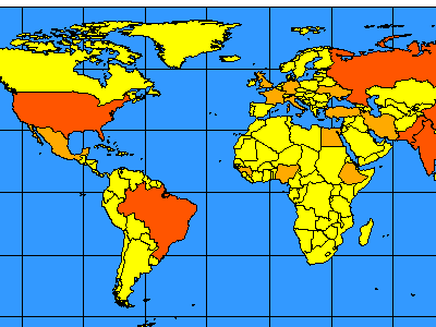

The following two figures show the difference when reaspect is used. The figure on the left has reaspect set to "true". The ENVELOPE is recalculated so that the map does not stretch. The figure on the right has reaspect set to "false", and the map has been stretched to fit the viewing area.
reaspect="true"
reaspect="false"

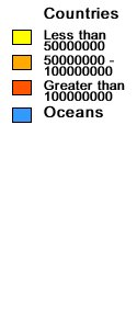

- LEGEND. LEGEND defines a map's legend for an Image Service. This legend is valid only in customized ArcIMS HTML Viewers and not in the ArcIMS Java Viewers or ArcExplorer 9. When LEGEND is included in the map configuration file, a legend image is always generated. However, this legend is ignored by the ArcIMS HTML Viewer. The HTML Viewer generates a legend upon request and ignores any other generated legends. For more information on using LEGEND, see the Using LEGEND and Draw Section in Using GET_IMAGE and IMAGE.

The map configuration file contains information on the locale, map properties, workspaces, and how each layer should be drawn. In the ENVIRONMENT section, the LOCALE country and language are the "US" and "En". For UIFONT, the default font of Arial is used, and the default dpi in SCREEN is 96. The PROPERTIES elements show that the MAPUNITS are in decimal degrees and the ENVELOPE coordinates are -135.0 -64.0 and 84.0 86.0. In the WORKSPACES section, one SHAPEWORKSPACE is included for shapefiles in the WORLD ESRIDATA dataset.
The map contains two layers:
- Ocean. This layer contains one renderer, SIMPLERENDERER. The layer has a solid blue fill as described in SIMPLEPOLYGONSYMBOL.
- Countries. This layer contains several renderers. A VALUEMAPRENDERER is used to define how each country should be colored based on population. Countries with a population less than 50 million are yellow, those with a population between 50 and 100 million are light orange, and those with a population greater than 100 million are dark orange. A SCALEDEPENDENTRENDERER is used for labeling. The labels do not turn on until the scale is less than 1:35000000.
The following figure shows a map drawn based on the instructions in the map configuration file.

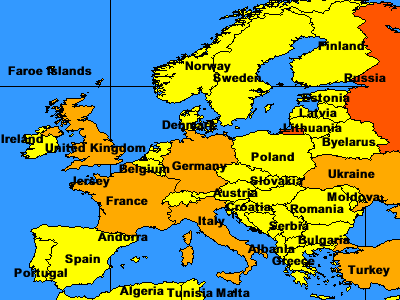

If the initial extent is changed so the scale is less than 1:35000000, the map zooms in enough so that labels for countries appear.
Change in initial ENVELOPE
<?xml version="1.0" encoding="UTF-8"?>
<ARCXML version="1.1">
<CONFIG>
<ENVIRONMENT>...</ENVIRONMENT>
<MAP>
<PROPERTIES>
<ENVELOPE minx="-13.0" miny="36.0" maxx="34.0" maxy="69.0" name="Initial_Extent" />
<MAPUNITS units="decimal_degrees" />
<FILTERCOORDSYS id="4326" />
<FEATURECOORDSYS id="4326"/>
</PROPERTIES>
<WORKSPACES>...</WORKSPACES>
<LAYER>...</LAYER>
</MAP>
</CONFIG>
</ARCXML>
The following figure shows a map at a scale of about 1:35000000 and includes labels.

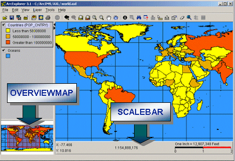

The additional elements are:
- IMAGESERVERWORKSPACE. IMAGESERVERWORKSPACE is included in the WORKSPACES section when an Image Service is accessed.
- FEATURESERVERWORKSPACE. FEATURESERVERWORKSPACE is included in the WORKSPACES section when a Feature Service is accessed.
- MOIMSWORKSPACE and AVIMSWORKSPACE. These two elements are included in the WORKSPACES section when a map is accessed from an ArcExplorer-enabled map in MapObjects IMS or from ArcView IMS, respectively.
- SCALEBAR and OVERVIEWMAP. These two elements are client configuration elements that add a scale bar or overview map, respectively.

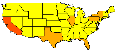

After layer rendering has been changed in the viewer configuration file
<LAYER type="featureclass" name="States" visible="true" id="1">
<DATASET name="2" type="polygon" workspace="ifs_ws-7" />
<VALUEMAPRENDERER lookupfield="POP1999">
<RANGE lower="482025" upper="11351422" label="Less than 11351422">
<SIMPLEPOLYGONSYMBOL boundarytransparency="1.0" filltransparency="1.0" fillcolor="255,255,0" boundarycaptype="round" />
</RANGE>
<RANGE lower="11351422" upper="22220818" label="11351422 - 22220818">
<SIMPLEPOLYGONSYMBOL boundarytransparency="1.0" filltransparency="1.0" fillcolor="255,170,0" boundarycaptype="round" />
</RANGE>
<RANGE lower="22220818" upper="33090215" label="22220818 - 33090215">
<SIMPLEPOLYGONSYMBOL boundarytransparency="1.0" filltransparency="1.0" fillcolor="255,85,0" boundarycaptype="round" />
</RANGE>
</VALUEMAPRENDERER>
</LAYER>
Remember that in a viewer configuration file, any rendering changes remain local to the machine that the configuration file resides on. The change does not affect the Feature Service.

References to an ArcExplorer-enabled MapObjects IMS map in MOIMSWORKSPACE are made in the service attribute. In the above example, the name of the map is "GPS_Points". The url attribute gives the location of esrimap.dll located on the machine with MapObjects IMS. ArcExplorer-enabled maps do not work with the ArcIMS Servlet Connector. However, the ArcIMS Servlet Connector can be used with regular MapObjects IMS sites.
The DATASET name references the machine and domain and the MapObjects IMS map name separated by a colon (:). In the above example, the DATASET name is "mymachine.domain.com:GPS_Points".
SHAPEWORKSPACE, IMAGEWORKSPACE, and SDEWORKSPACE are used when local data is referenced in the viewer configuration file. These WORKSPACES elements reference data exactly the same way as in a map configuration file.
OVERVIEWMAP and SCALEBAR are client configuration elements and add an overview map or scale bar, respectively.
Both elements are saved when using ArcExplorer 9 or an ArcIMS Java Standard Viewer. Only SCALEBAR is saved in an ArcIMS Java Custom Viewer even if an overview map is present. Also, the ArcIMS Java Custom Viewer ignores these elements when a viewer configuration file is read into the viewer.

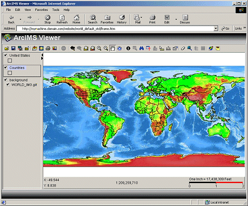

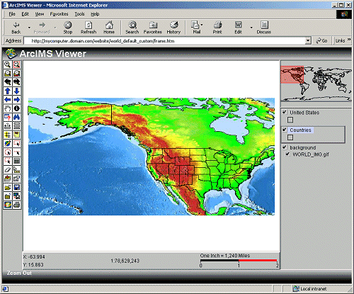

Default.axl is a special viewer configuration file that is output by ArcIMS Designer when an ArcIMS Java Viewer is created. The diagram below shows the process to create default.axl:
- In Step 1, one or more ArcIMS services are selected during the ArcIMS Designer process.
- In Step 2, when a Web site is generated, one of the output files in the directory is default.axl.
- In Step 3, when an ArcIMS Java Standard or Java Custom Viewer is opened, default.axl is loaded in the viewer. The file contains information on which services should be loaded in the viewer.
Default.axl uses a subset of elements normally found in a viewer configuration file. Its primary purpose is to load ArcIMS service layers specified during the ArcIMS Designer process.
