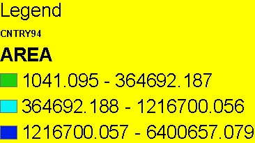

When using layerfontsize.  Sets the font size of the subheading for layers that include a value map. The font style and color cannot be changed.  In this example, the subheading is "AREA". <LEGEND autoextend="true" title="A Sample Legend" font="Times New Roman" titlefontsize="16" valuefontsize="16" layerfontsize="20" />  |
