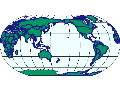

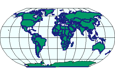

| Displaying the world using the Sinusoidal projection (left) and the Robinson projection (right). | |
