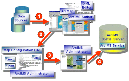

| Author | ArcXML file | *.axl | Feature and Image Services |
| XML Editor | ArcXML file | *.axl | Feature and Image Services |
| ArcMap | ArcMap map file | *.mxd | ArcMap Image Services |
| ArcMap | Published map file | *.pmf | ArcMap Image Services |

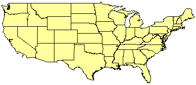

Reaspect set to true
Reaspect set to false

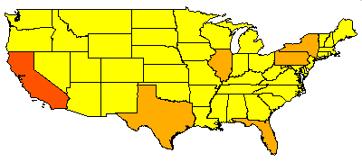

| After layer rendering has been changed in the viewer configuration file: |
<LAYER type="featureclass" name="States" visible="true" id="1"> <DATASET name="2" type="polygon" workspace="ifs_ws-7" /> <VALUEMAPRENDERER lookupfield="POP1999"> <RANGE lower="482025" upper="11351422" label="Less than 11351422"> <SIMPLEPOLYGONSYMBOL boundarytransparency="1.0" filltransparency="1.0" fillcolor="255,255,0" boundarycaptype="round" /> </RANGE> <RANGE lower="11351422" upper="22220818" label="11351422 - 22220818"> <SIMPLEPOLYGONSYMBOL boundarytransparency="1.0" filltransparency="1.0" fillcolor="255,170,0" boundarycaptype="round" /> </RANGE> <RANGE lower="22220818" upper="33090215" label="22220818 - 33090215"> <SIMPLEPOLYGONSYMBOL boundarytransparency="1.0" filltransparency="1.0" fillcolor="255,85,0" boundarycaptype="round" /> </RANGE> </VALUEMAPRENDERER> </LAYER> |

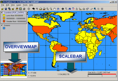

| Using OVERVIEWMAP and SCALEBAR: |
<?xml version="1.0" encoding="UTF-8"?> <ARCXML version="1.1"> <CONFIG> <ENVIRONMENT>...</ENVIRONMENT> <MAP>...</MAP> <OVERVIEWMAP backgroundcolor="255,255,255" framefillcolor="255,0,0,80" frameoutlinecolor="255,0,0" zoomfactor="4.0"> <LAYERDEF name="Oceans" /> <LAYERDEF name="Countries" /> </OVERVIEWMAP> <SCALEBAR backcolor="212,208,200" fontcolor="0,0,0" mapunits="decimal_degrees" scaleunits="feet" screenunits="inches" /> </CONFIG> </ARCXML> |

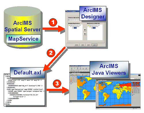

| Example default.axl file: |
<?xml version="1.0" encoding="UTF-8"?> <ARCXML version="1.1"> <CONFIG> <MAP> <PROPERTIES> <ENVELOPE minx="-180.0" miny="-90.0" maxx="180.0" maxy="90.0" name="Initial_Extent" /> <MAPUNITS units="decimal_degrees" /> </PROPERTIES> <WORKSPACES> <IMAGESERVERWORKSPACE name="mapper_ws-6" url="http://mycomputer.domain.com/servlet/com.esri.esrimap.Esrimap" service="background" /> <FEATURESERVERWORKSPACE name="ifs_ws-7" url="http://mycomputer.domain.com/servlet/com.esri.esrimap.Esrimap" service="World" /> </WORKSPACES> <LAYER type="image" name="background" visible="true" id="0"> <DATASET name="background" type="image" workspace="mapper_ws-6" /> </LAYER> <LAYER type="featureclass" name="Countries" visible="true" id="1"> <DATASET name="0" type="polygon" workspace="ifs_ws-7" /> </LAYER> <LAYER type="featureclass" name="United States" visible="true" id="2"> <DATASET name="1" type="polygon" workspace="ifs_ws-7" /> </LAYER> </MAP> <SCALEBAR backcolor="212,208,200" fontcolor="0,0,0" mapunits="decimal_degrees" scaleunits="feet" screenunits="inches" /> </CONFIG> </ARCXML> |

| Including SCALEBAR: |
<?xml version="1.0" encoding="UTF-8"?> <ARCXML version="1.1"> <CONFIG> <MAP>...</MAP> <SCALEBAR backcolor="212,208,200" fontcolor="0,0,0" mapunits="decimal_degrees" scaleunits="feet" screenunits="inches" /> </CONFIG> </ARCXML> |
