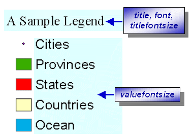

Attribute Description Table
When parent element is IMAGE: file ="string" url ="string" type ="gif | jpg | png | png8" When parent element is PROPERTIES when using ArcMap Server: autoextend ="true | false" [false] backgroundcolor ="0,0,0 - 255,255,255" display ="true | false" [true] font ="Any system font" [Arial] layerfontsize ="integer" [10] swatchheight ="integer" [14] swatchwidth ="integer" [18] title ="string" titlefontsize ="integer" [12] valuefontsize ="integer" [8] When parent element is PROPERTIES when using Image Server: anitaliasing ="true | false" [true] autoextend ="true | false" [false] backgroundcolor ="0,0,0 - 255,255,255" cansplit ="true | false" [false] cellspacing ="integer" [2] columns ="integer" [1] display ="true | false" [true] font ="Any system font" [Arial] height ="1 - NNN" [300] layerfontsize ="integer" [10] reverseorder ="true | false" [false] splittext ="string" [(cont)] swatchheight ="integer" [14] swatchwidth ="integer" [18] title ="string" titlefontsize ="integer" [12] transcolor ="0,0,0 - 255,255,255" valuefontsize ="integer" [8] width ="1 - NNN" [125] > When parent element is IMAGE: No Child Elements When parent element is PROPERTIES when using ArcMap Server: No Child Elements When parent element is PROPERTIES when using Image Server: (m) <LAYERS... /> </LEGEND > | |

| autoextend | Extends the legend to accommodate information for all layers. Should always be set to "true" with ArcMap Server. | |
| backgroundcolor | Legend’s background color using RGB values. | |
| display | Turns legend on or off. | |
| font | Font for title. The name is case sensitive. If font name uses "&", use "&" instead. For example, ESRI Transportation & Civic should be written as ESRI Transportation & Civic. | |
| layerfontsize | Sets the font size of the childheading for layers that include a value map. | |
| swatchheight | Height of the symbol swatch in pixels. | |
| swatchwidth | Width of the symbol swatch in pixels. | |
| title | Title of legend. | |
| titlefontsize | Font size for title. | |
| valuefontsize | For layers that include a value map, it sets the font size for value map labels. For layers with no value map, it sets the font size for the layer name. | |
