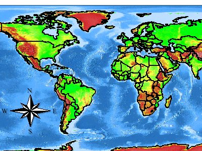

| Using GET_SERVICE_INFO and SERVICEINFO with Image and Feature Services |
| Layer Name | Data Name | Data Type | Layer ID |
| Background | WORLD_IMG.gif | Image | 0 |
| Countries | CNTRY94 | Polygon | 1 |
| northarrow | None | Acetate | northarrow |
| Map configuration file used with the GET_SERVICE_INFO requests that follow: |
