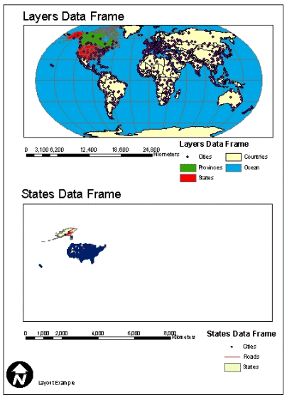

| Simple GET_LAYOUT request: |
<?xml version="1.0" encoding="UTF-8" ?> <ARCXML version="1.1"> <REQUEST> <GET_LAYOUT> </GET_LAYOUT> </REQUEST> </ARCXML> |
| LAYOUT response: |
<?xml version="1.0" encoding="UTF8"?> <ARCXML version="1.1"> <RESPONSE> <LAYOUT> <ENVELOPE minx="-3.08333333333333" miny="0" maxx="11.5833333333333" maxy="11" /> <OUTPUT url="http://mycomputer.domain.com/output/world_MYCOMPUTER2102209.png" file="c:\arcims\output\world_MYCOMPUTER2102209.png" /> </LAYOUT> </RESPONSE> </ARCXML> |

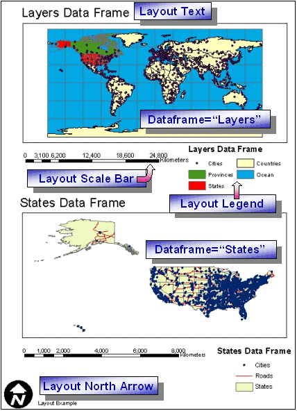

| GET_LAYOUT request with PROPERTIES and DATAFRAME: |
<?xml version="1.0" encoding="UTF-8"?> <ARCXML version="1.1"> <REQUEST> <GET_LAYOUT> <PROPERTIES> </PROPERTIES> <DATAFRAME id="Layers" > </DATAFRAME> <DATAFRAME id="States" > </DATAFRAME> </GET_LAYOUT> </REQUEST> </ARCXML> |

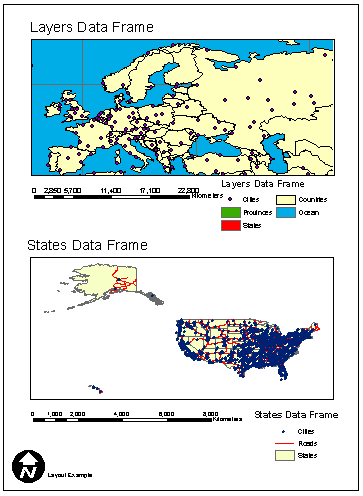

| Using ENVELOPE in PROPERTIES and DATAFRAME: |
<?xml version="1.0" encoding="UTF-8"?> <ARCXML version="1.1"> <REQUEST> <GET_LAYOUT> <PROPERTIES> <ENVELOPE minx="0" miny="0" maxx="8.5" maxy="11" /> </PROPERTIES> <DATAFRAME id="Layers" > <ENVELOPE minx="-144" miny="19" maxx="-52" maxy="81" /> </DATAFRAME> <DATAFRAME id="States" > <ENVELOPE minx="-94" miny="32" maxx="-73" maxy="46" /> </DATAFRAME> </GET_LAYOUT> </REQUEST> </ARCXML> |
| LAYOUT response: |
<?xml version="1.0" encoding="UTF8"?> <ARCXML version="1.1"> <RESPONSE> <LAYOUT> <ENVELOPE minx="0" miny="0" maxx="8.5" maxy="11"/> <OUTPUT url="http://mycomputer.domain.com/output/world_MYCOMPUTER2102209.png" file="c:\arcims\output\world_MYCOMPUTER2102209.png" /> </LAYOUT> </RESPONSE> </ARCXML> |

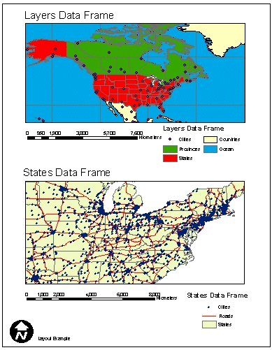

| Using SCALE in DATAFRAME: |
<?xml version="1.0" encoding="UTF8"?> <ARCXML version="1.1"> <REQUEST> <GET_LAYOUT> <PROPERTIES> <ENVELOPE minx="0" miny="0" maxx="11" maxy="8.5" /> </PROPERTIES> <DATAFRAME id="Layers"> <SCALE rf="15000000" x="13.3" y="52.8" /> </DATAFRAME> </GET_LAYOUT> </REQUEST> </ARCXML> |
