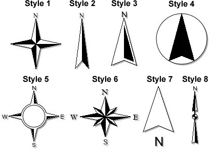

| type | Value representing north arrow type. | |
